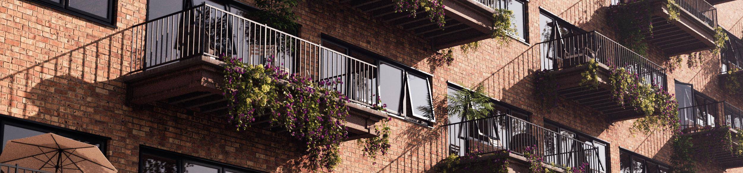

Creating Large Numbers of Hanging Plants
Learn how to add large numbers of hanging plants for balconies by combining ForestIvy with ForestPack

In this final tutorial of the 3 part mini-series, we’ll focus on distributing hanging plants along balcony edges. While you could use ForestIvy alone by drawing a growth spline for each balcony, that approach is time-consuming and impractical for buildings with many balconies, especially if the size of shape is likely to change during the design process. Instead, we’ll combine ForestIvy to create small clumps or plants, and ForestPack to distribute them, for a more efficient and flexible workflow.
By the end of this tutorial, you’ll have a setup where the hanging plants, balconies and items on the balconies all update automatically if the balconies’ size, shape, or position changes—thanks to a sharing a single set of splines.

In this tutorial, we’ve combined the strengths of ForestIvy and ForestPack to efficiently distribute hanging plants along balcony edges. This method keeps the entire setup procedural and easy to update. Whether you need to adjust balcony sizes, shapes, or positions, everything—including the plants—will update automatically.
