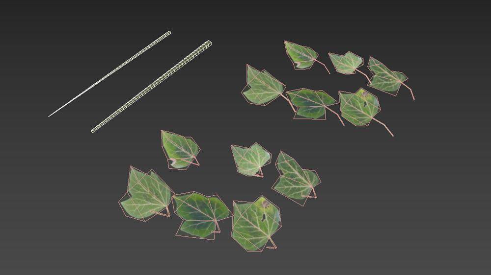

The macro expects two types of geometry, a stem and some leaves. The stem has enough edge loops to deform around the spline but otherwise, it’s just a tapered cylinder. The leaves have the pivot moved to the end of the stem. I have a second set too, they’re the same leaves but I’ve bent the stem underneath and realigned the pivots. We will alternate between these two groups to create a pattern of ivy that alternates on either side of the splines, an effect that is usually most visible when the plants grow horizontally. We’ve provided geometry, but you can easily use your own

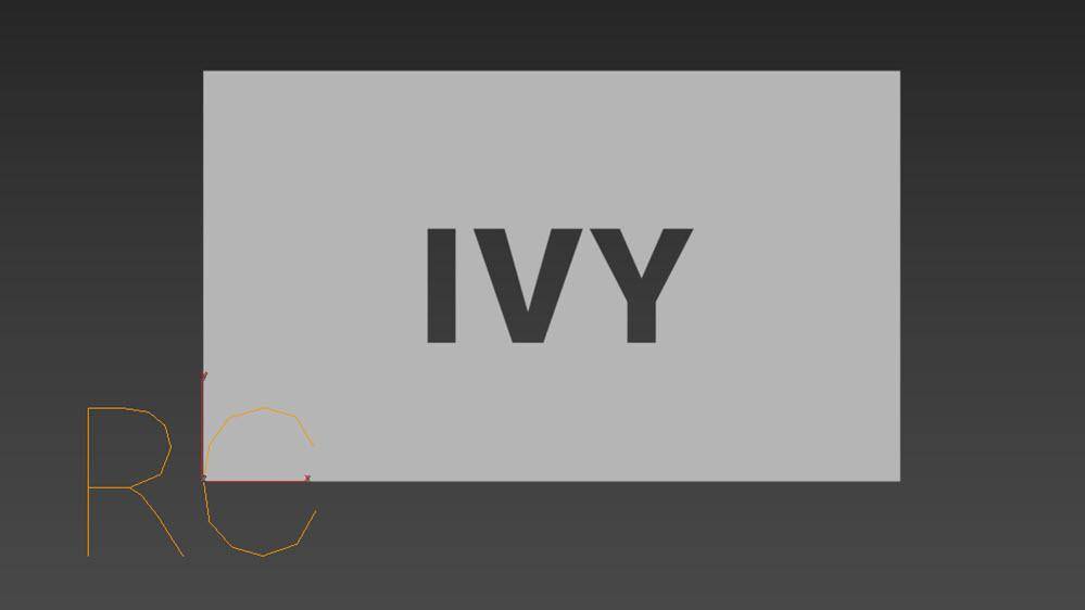

Select the RC_Ivy_Start object. The first thing to note is that the RailClone object is rotated to align to the wall you wish to use for the Ivy. This is important for two reasons, the macro will use this orientation to make sure the leaves are facing away from the wall, but it’s also necessary to ensure that they always remain vertical as is often seen in nature to maximise exposure to sunlight.
It’s also positioned at the bottom of the wall because as we’ll see, the macro has altitude parameters that are measured from the RailClone object’s coordinates.

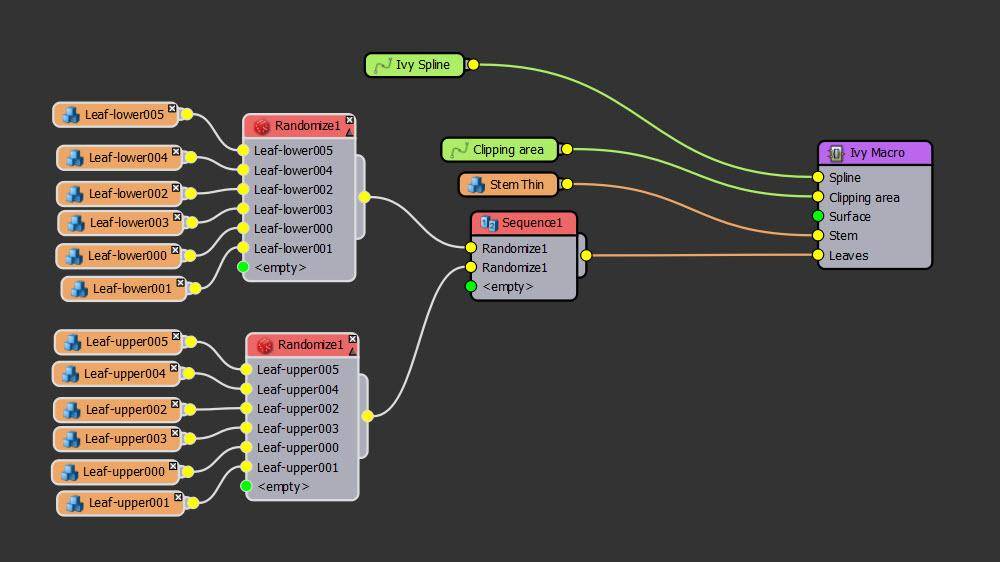

Open the style editor and you’ll find two macros. We’ll come back to the branch maker later. Let’s import the geometry:
  1. Create a Segment node. Right-click on it and choose Clone Multiple.
  2. Pick all the leaves from one of the groups. I’ll pick all the ones with a Lower suffix.
  3. Create a new Randomize Node and wire the new segments to its inputs.
  4. Now we’ll import the other group. Select one of the Segment nodes and Clone Multiple.
  5. Pick the other type of leaves, these have the suffix Upper
  6. Wire the new Segments to a second Randomize node.
  7. Create a new Sequence operator and wire the two Randomise nodes to its inputs. This will create an alternating pattern of upper and lower leaves.
  8. Wire the Sequence node to the Macro’s Leaves input
  9. Add a new Segment node and pick the stem geometry. Wire it to the Stem input
  10. Add a Spline node and wire it to the Macro’s Spline input

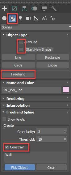

That’s the macro setup now we need a spline to use in that node. To create one I’ll use Max’s built-in Freehand drawing tool.
  1. Pick the Freehand tool and disable AutoGrid and Start New Shape. This second one is important because it will ensure that each new spline you draw is a part of a single spline object. It saves you from having to connect them all manually later.
  2. Turn on Constrain, and pick the wall.
  3. That’s it, you can just draw your shape. I rather like this step, you have a lot more control than letting an algorithm take care of it for you. Nonetheless, you should try to create a realistic(ish) pattern of branching stems.
  4. Assign the path in the Spline node and you should get an Ivy mesh!

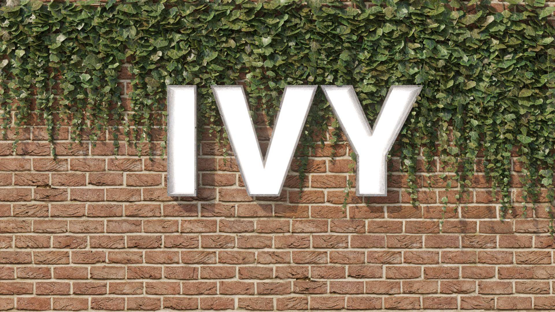

Finally, there is another macro called Ivy Brance Maker. This can be useful to create the effects you see when Ivy branches hang down from a wall in tendrils instead of climbing. It works in conjunction with the existing macro. To illustrate, I’ll draw some horizontal lines at the top of the wall.
  1. Assign the RailClone object to the new spline
  2. Wire one of the Randomise nodes to the Branch Maker macros Leaf input (it doesn't matter which)
  3. Wire the Stem Segment to the Stem input.
  4. Select the Macro and select Show Preview. A straight branch will be created at the RailClone object’s pivot point.
  5. As with the main macro, you have parameters to control the spacing and the size at the start and the end of the branch, as well as the overall length using the X Size property.
  6. When you have a branch size that you like, wire the branch maker macro to the Ivy Macro’s Leaf input
  7. I’ll turn off the Altitude and Spline Position effects for this one. Be aware that there’s some advanced nesting going on here, so it may be a little slow to build.
  8. You’ll now have hanging tendrils of ivy instead of climbing vines!
  9. Note that you can also use a spline for the branch path, but you’ll need to ensure that the first vertex is aligned to the RailClone object’s pivot to ensure that the geometry aligns correctly.
  10. I’ll add a clipping spline to remove this ivy from the text - it could be a window you need to remove. It’s as simple as picking a spline and wiring it to the Clipping input.
