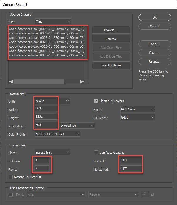

  3. Now select File > Automate > Contact Sheet in Photoshop.
    Contact Sheet II
  4. Enter the Height and Width of the final texture, in this example 3630 x 2261, and the Resolution, which in our example is 300DPI.
  5. Enter the number of Rows and Columns you’ve calculated you’ll need. In this example, just 1 column is fine with 7 rows.
  6. Now you need to set the Spacing Vertical and Horizontal values to 0px so there are no gaps between planks. There’s a catch though, Photoshop will not let you set this value to zero. To get around that, change the units temporarily to CM, enter 0cm for both these values, and then change back to Pixels. The settings should now read 0px
  7. Finally, let’s pick the files. Click Browse and select your bitmaps. Click Open to add them to the Source Images list.
  8. Click OK to build your texture.
  9. Once the texture has been generated, resize it to the nearest power of 2 resolution and save.

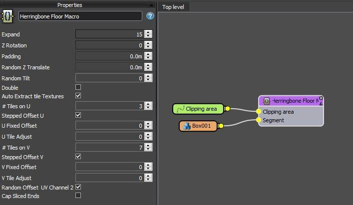

  2. In this example, we’ll be using the Herringbone Floor macro. RailClone uses closed splines to determine the floor area. To select one from the scene, add a new Spline node and wire it to the Macro’s Spline input.
  3. Next, you need to add the plank geometry. Add a Segment node, wire it to the Macro  and go to the Properties panel. Click on the Object Picker button and select the plank geometry from the scene. Your floor will be generated - let’s take a look at some of the settings in the macro.
  4. Around the boundary of the floor (depending on the pattern), you may see some gaps. To remove these increase the Expand property.
  5. If you wish to change the direction that the planks run you use the Z Rotation property.
  6. Padding allows you to add spacing around the planks.
  7. Random Z Translate will create some stepped unevenness in the boards by randomly offsetting them on the Z-Axis. It’s best to use small values here unless you’re creating an old dilapidated room. In a similar vein, the Random Tilt property will randomise the rotation of each plank.
  8. There’s also a Double option for a different herringbone style.
  9. The other macros have a few different options. For example, the Chevron Macro requires you to enter the thickness of the plank in order to correctly calculate the spacing. The Basket Weave Macro has options to control the number of repetitions on the X and Y axes separately. Finally, the Planks macro has options to randomise the height of Rows and randomise the Offset of the boards.
Whichever macro you use, we’re focussing today on the options that allow you to automatically extract the planks from the textures we created earlier. Before we take a look at these, let’s create a material so we can see what’s going on.

  1. IMPORTANT. Unless you are using V-Ray, go to the Display rollout and disable Instancing Engine. If you don’t do this then RailClone’s UV manipulation tools will not work. V-Ray users can skip this step
  2. Go back to the Macro’s properties. Enter the number of planks found horizontally in your texture for the #Tiles On U value. In our case, we had just one, but we can subdivide that into 3 to get a few more variations and to illustrate the principle.
  3. Enter the number of planks found vertically for the #Tiles on V value. In our example, we had 7. That’s all you need to do, we now have 21 variations of planks from one easy to manage shader setup. Best of all this doesn’t rely on any 3rd party shaders so it’ll export to nearly anything. You can also collapse it to an editable mesh without losing the randomisation effect if you want to share it with someone who does not have access to RailClone.
  4. The other settings here can be used to further crop into the planks. This can be useful if, for example, the source texture has grout or joints that you’d like to remove. There’s also an option to Disable Stepped offset. This can be useful if your textures are a continuous tiling texture like a veneer.

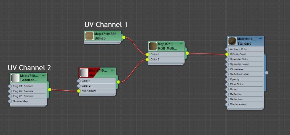

That takes care of materials - how about randomising tint? To do that we will use UV channel 2. But first the principle in the materials setup.
  1. Create a new Gradient map. Leave it at its default setting except for changing the Map Channel to 2. We’re going to sample a small part of this gradient and randomly change the U and V offset so that each plank picks up a different value. To make it easier to edit this effect though, let’s add Mix map.
  2. Wire the Gradient to the Mix map’s Alpha input. You can now easily change the tint values using the Colour #1 and Colour #2 swatches.
  3. Let’s combine this with the existing diffuse map. Wire an RGB Multiply map between the existing Diffuse map and the material. Wire the Mix map to the RGB Multiply Map’ssecond input.
  4. Previewing UV channel 2 in the viewports can be a pain in Max. One way to do it is to ensure that the material itself is not being previewed. Then you can select the gradient or the Mix map and enable Show Shaded Map in the Viewport. You can now see the gradient applied to each plank.

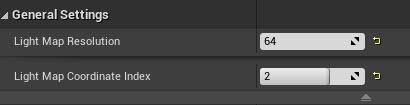

  4. We need to tell Unreal which of our 3 existing UV channels to use for Light Mapping. To do this, double click on the asset to open the editor. Find the Lightmap Coordinate Index parameter and change the value to 2. You might wonder why 2 and not 3? It’s because Unreal’s Lightmap channels start from 0, whereas Max’s start from 1.
    Light Map Settings
  5. To improve the quality of the shadows, you can also increase the Light Map Resolution if you like.

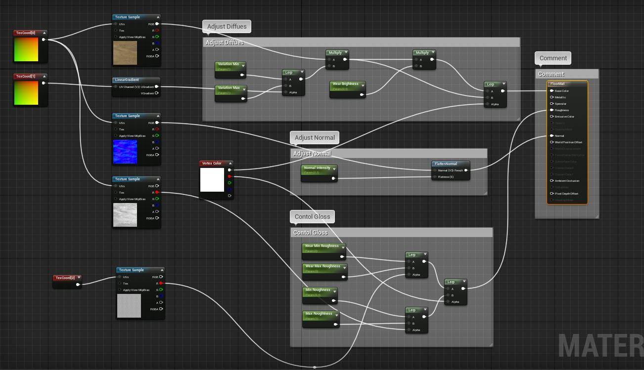

That’s pretty much a straight recreation of the Max material in Unreal. But let’s use these same node types to add a few more parameters. Starting with the ability to control the minimum and maximum Roughness.
  1. Wire a new Lerp between the Roughness map and the material. The Roughness will be wired to the Lerp’s Alpha input
  2. Create two new Constants wired the new Lerp’s A and B inputs.
  3. Convert them to Parameters name RoughnessMin and RoughnessMax.
  4. You can now adjust the minimum and maximum roughness of the boards as well as the tint variation very easily.
One of the advantages of having real geometry in the scene is that you can easily set up a material that uses Vertex Colours to paint in variation exactly where you need it. In the next section, we’ll use this approach to control the brightness of the diffuse by painting with a brush.
  1. Wire a new Lerp node to the Base Colour with the existing Multiply node in its B input.
  2. Create a new Multiply node and wire it to the Lerp node’s first input. Wire the existing Multiply node to its first input.
  3. Create a Constant and wire it to the Multiply Node’s Second input. Convert it to a Parameter called WearBrightness.
  4. Add a VertexColor node and wire it to the final  Lerp’s Alpha input.
  5. You can now select the floor and go into Vertex Paint mode. Painting with Black will reveal the worn area. In this example I’m using the default colour settings and holding down Shift while painting to use the Erase colour (which is black).
  6. We can do the same thing for the Glossiness. Clone the existing Roughness, Lerp and Parameter nodes. Rename the parameters WearRoughnessMin and WearRoughnessMax.
  7. Change the map to a Grunge texture.
  8. Wire a new Lerp map to the Roughness input
  9. Wire the Grunge Roughness nodes to the first input
  10. Wire the Floor Roughness nodes to the second input
  11. Wire the Vertex Colour map to the Alpha.
