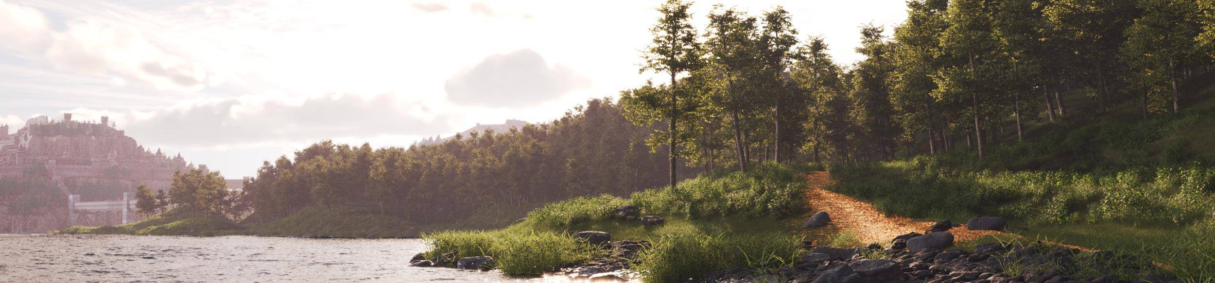

When that’s done, it’s important to note that although they are all sharing the same set of surfaces, each Forest Object still uses its own parameter values. This allows us to use the same surface, but for example, use a different Altitude range to constrain the reeds and stones so that they only appear around the water line.
And here’s how this all pays off. If I nowselect my Parent object and assign this surface, you can see that all 4 Forest Objects are updated in one click, like a little ready-made ecosystem that’s based on the water level to add different scatters.
I can easily add additional surfaces to this Parent, and again all 4 scatters will be updated to add the ecosystem to this other bank on the left of the scene.

In this case though, rather than load the entire contents of another Forest Object’s Areas list, instead you can link to them individually. To illustrate, I’ll select the grass scatter and add a Paint areas in Exclude mode. I can then use this to remove some grass to add a path.
Now, if I wanted another scatter to add some stones, leaves or other things to the path I don’t really want to have to paint that all again. It’s inefficient and later if I change that path I don’t want to have to do it from 2 or more different Forest Objects.  Instead, I’ll link it to the existing area. Here’s how
  1. First I’ll add the surface, like we did above.
  2. Next go to the Areas rollout. There’s a new button here called Add Linked Area.
  3. I’ll click it and select the Grass Forest object
  4. The drop-down list allows you to select the Area in the linked Forest Object that you’d like to use. In this case I’ll pick the Paint area.
  5. Although the area is linked, it retains its own local parameters. This means that although the original area was set to Exclude, in this scatter I can use it as an Include area.
  6. Now if I go back to the Grass layer and start painting, you can see that in this scatter I am excluding the grass, but at the same time I am automatically adding leaves to the path using a second Forest Pack object.
