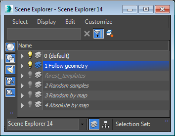

This file contains a simple plane with arrows on it, the arrows are distributed with Forest Pack and laid out in a grid so that we can easily see the effects of changes to the animation controls. Also in the scene, to the left of the plane, are 5 animated objects that we'll use in later exercise. If you click on Manage Layers
, you'll see there are 4 layers, one for each animation mode. Unhide the layer called 1 Follow Geometry.

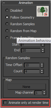

Follow Geometry mode
- Select the Forest Pack object called fp_follow.
- Open the Animation rollout. Change the mode from Disabled to Follow Geometry.
- Now if you scrub the timeline... still nothing happens. However if you render a few frames, animation is working. This is to maintain performance. By default Forest Pack does not preview the animation in the viewports. To enable viewport previews, uncheck Animate Only at Render Time from the bottom of the animation rollout. Now if you scrub the timeline it works in the viewports, and at render time, as expected.

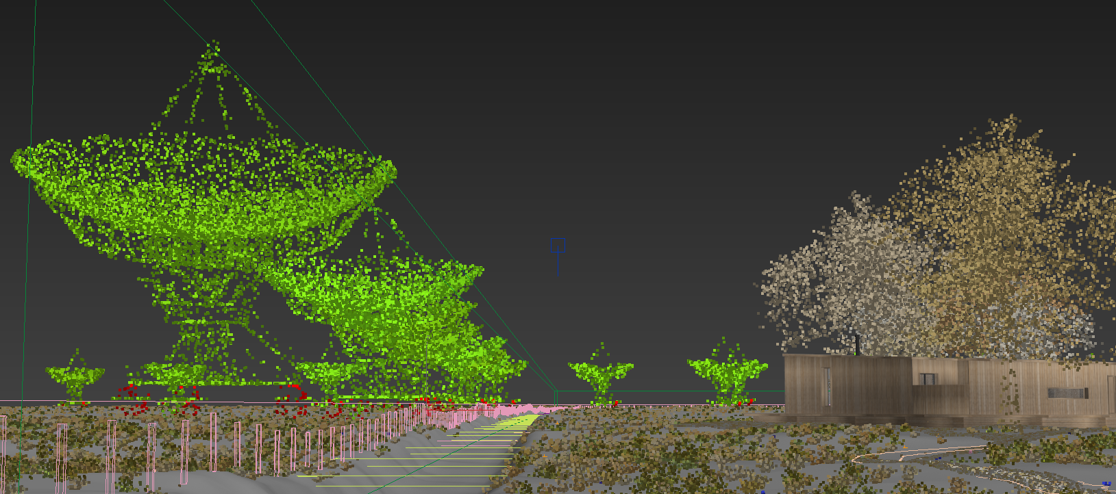

In these exercise files, to make things clearer in the viewport, Forest Pack has been set to display the scattered objects as meshes. If the geometry was more dense, or the scatter area larger this might not be possible. Fortunately Points-Cloud mode also enables you to preview animations, allowing you to get a good indication of the rendered results of more complex scenes. To illustrate this try the following:

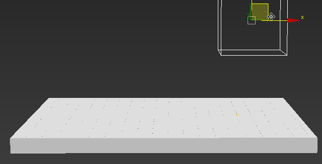

- Open the Display Rollout and set the mode to Points-Cloud.
- Select the plane and change the size from 20 x 20m to 600 x 600m.
- Scrub the timeline. You'll see you can still get a decent idea of the animation in the viewports, despite the huge number of instances. Though this geometry is simple, the same would apply for much more complex models.

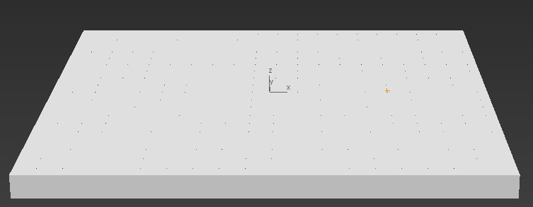

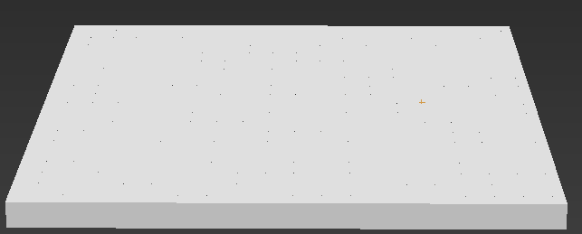

- Unhide the layer called 2 Random Samples and change the view to the Cam Random Sample camera.

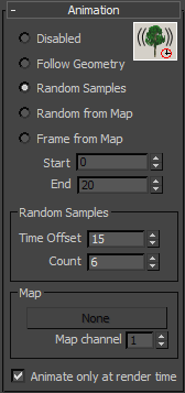

- Select the Forest object called fp_random.
- Open the Animation rollout and check Random Samples.
- Scrub the timeline, the arrow's playback is now randomised.

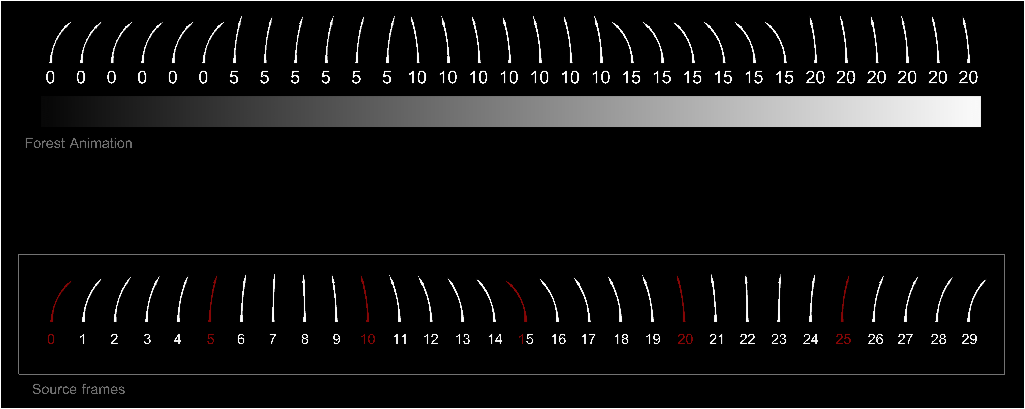

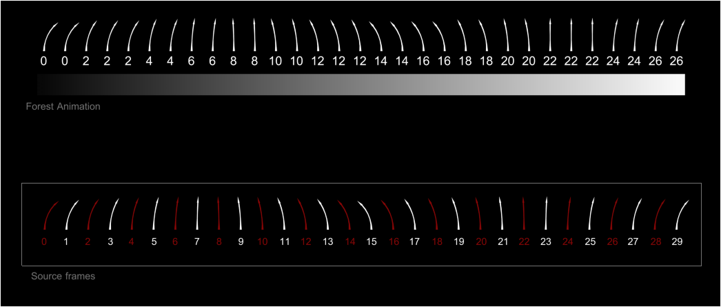

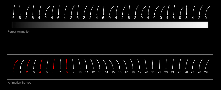

You'll notice when you activate Random Samples mode that the Time Offset and Count parameters become available. These are used to control the sample points along the timeline. To create the points, the Count parameter defines the total number of samples, while Time Offset determines the number of frames between them, starting from frame 0.
For example, if we use a Count value of 5 and a Time Offset value of 2, we get the 5 samples points marked in red in the diagram below. These start from frame 0 with 4 further samples each taken 2 frames apart. The bottom row illustrates the sample points on a 30 frame animation on the source object. In the resultant scatter, shown on the top row, you can see that only these 5 frames are used as a starting point at frame 0.
Let's try another example. In the illustration below, the Time Offset value has increased to 5 and the Count is now 6. This returns 6 samples at frames 0,5,10,15,20 and 25, randomly scattered by Forest Pack Pro.
(Note that the larger samples value has resulted in a more pronounced difference in the resultant animation.)
Understanding the Count and Time Offset parameters is the key to mastering this mode and the next, Controlling the starting frame using a map.

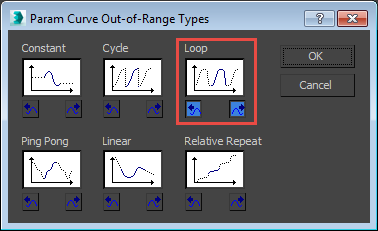

Use parameter curve out-of-range types to create loops

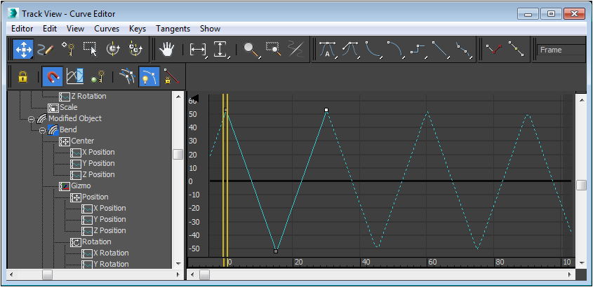

Probably the easiest way to create a looped animation is to use the Parameter Curve Out-Of-Range options found in the graph editor. To illustrate we'll make the arrow animation repeat, instead of stopping at frame 30.

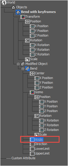

- Select the arrow name Bend with keyframes and open the Curve Editor by clicking
or going to Graph Editors > Track View - Curve Editor ... - From the Controller View in the Curve Editor, locate the Bend with keyframes object and expand the tracks until you can select Modified Object > Bend > Angle.
![Animating in Forest Pack-image2015-2-13%2015%3A24%3A41.png]()
- Click
or go to Edit > Controller > Out Of Range Types. - From the Out Of Range Types dialogue, select Loop (or another appropriate type).
![Animating in Forest Pack-image2015-2-13%2015%3A26%3A55.png]()
- Note that the graph now shows a dotted line to indicate the new looped animation
![Animating in Forest Pack-image2015-2-13%2015%3A29%3A18.png]()

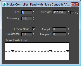

Instead of looping keyframed animation, some foliage animations lend themselves to noise controllers. Using these will create a lot more variation, avoiding the obvious repetition of a keyframed loop and the animation can never accidentally stop. To add a noise controller to create the arrow animation:

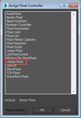

- Select Bend with Noise Controller from the scene and open the Curve Editor by clicking
or going to Graph Editors > Track View - Curve Editor ... - From the Controller View in the Curve Editor, locate the Bend with keyframes object and expand the tracks and right click on Modified Object > Bend > Angle.
- From the Assign Controller dialog, select Noise Float.
![Animating in Forest Pack-image2015-2-13%2015%3A50%3A38.png]()
- From here you can set the strength and frequency of the noise. You'll want a low frequency setting of approximately 0.01 and strength of about 450, but feel free to play with these settings to get interesting alternate results. If you play the animation the results of your changes to the noise controller can be previewed in real-time, making it much easier to get a satisfactory result.
![Animating in Forest Pack-image2015-2-13%2015%3A51%3A57.png]()
- Close the dialog and graph editor. This technique, coupled with the bend modifier generates some reasonably decent wind animations for grass and ground cover plants. The non GrowFX grass and tree included in the scene files use this technique. The tree also uses a vertices with soft selection passed up the stack to a noise modifier to create some smaller leaf animation. You can read more about this technique on Ramy Hanna's blog.

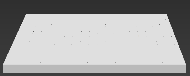

Instead of allowing Forest Pack to randomly distribute sample points you can use a grayscale map to precisely specify the placement of a sample point from which an animation will start. To illustrate this, if it's not already, open the animation_exercises.max file included in the downloads for this tutorial and do the following.

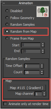

- Unhide the layer called 3 Random by Map and change the view to the Cam Random From Map camera.
- Select the forest object called fp_random_by_map
- Open the Animation rollout and check Random From Map.
- Click on the Map slot and select a Gradient map.
![Animating in Forest Pack-image2015-2-13%2019%3A7%3A1.png]()
- Click play, you'll now get a wave effect from front to back. To modify the map just instance it into the material editor, for example you could rotate it so that the wave effect animates from side to side.
These kind of effects are great for animations of wind moving across grass, where you will often witness gusts travelling from one side of a field to the other. Before going any further let's take a look at how this works. As in the previous example, the sample points are controlled using Time Offset and Count parameters to determine the number and frequency of sample points. With this mode however, they are placed on the surface using a map. For example, using a Time Offset value of 5 and Count of 6 we get sample points (shown in red) of 0, 5, 10, 15, 20, and 25. In the top row you can see how a gradient map controls their distribution. The grayscale range is equally divided by the Count value with the first frame represented by black and the last represented by white. When the colour exceeds a threshold, the next frame is displayed. This explains why you can't see frame 25 in the top row as the gradient is only pure white at the very end of the row.
In this second example you can see that if you increase the Count to 15 and decrease the Offset to 2 you'll see a much smoother wave animation in the top row.
More or less any map that is calculated before render time can be used to offset the animation. In particular noise maps are quite effective for creating wind animations across grass and large areas of forest.

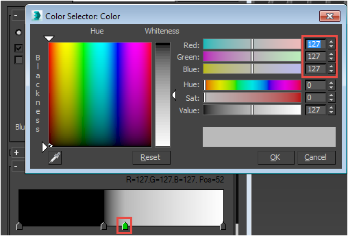

- Open the Material Editor and drag the Gradient map to an empty map slot.

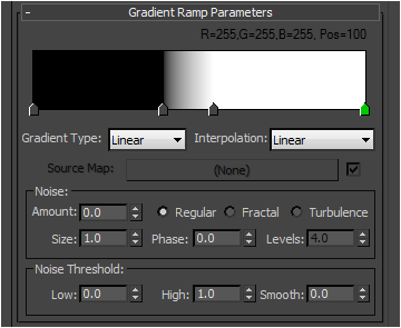

- In the Gradient Ramp Parameters, create a new flag just before the halfway point and set the colour to black. Create a second flag just after the halfway point and set the colour to white. You'll now have a gradient with a large black area at the beginning, a large white area at the end, and a short transition in between.
![Animating in Forest Pack-image2015-2-15%2016%3A37%3A48.png]()

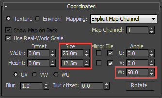

- From the material's Coordinates rollout, set the tiling to 0.2, turn on
and animate the U Offset value from 1 at frame 0 to -2 at frame 100. - Play the animation. You'll see the arrows grow grow from right to left, controlled by the map.

- Open the material editor and select the existing gradient. Select the 1st white flag and set the colour to RGB 127,127,127.

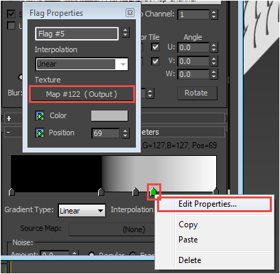

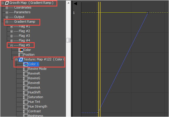

- Add a another flag just after this one, right click on the marker and select Edit Properties ... Click on the texture map slot and add an Output map.
![Animating in Forest Pack-image2015-2-15%2018%3A28%3A11.png]()

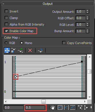

- In the Output Map, turn on Enable Color Map and adjust the curve so that the starting point's value is 0.5.
![Animating in Forest Pack-image2015-2-15%2018%3A21%3A35.png]()

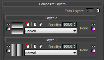

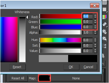

- Click on the Output's Map slot and add a Composite Map.
- In the Composite map, on the first layer click
and change the colour to white. Note that this map type uses floating point values, so enter 0.0 for Red, Green and Blue.
![Animating in Forest Pack-image2015-2-15%2018%3A6%3A9.png]()
- Turn on
and move the timeline to frame 30. Change the colour of the Colour Correct map to White by entering 1.0 for the RGB channels. - Go back to the Composite Map, and add a new layer by clicking
. - Click

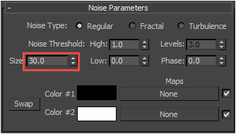

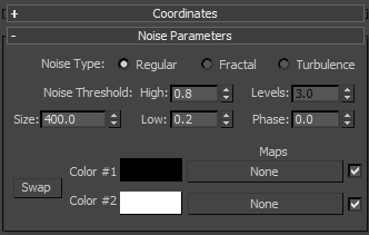

to add a new map to the layer and add a Noise map with a size of 400, a High value of 0.8 and a Low value of 0.2.![Animating in Forest Pack-image2015-2-15%2018%3A17%3A34.png]()
- Go back to the Composite map and set the blending mode for the noise layer to Difference.

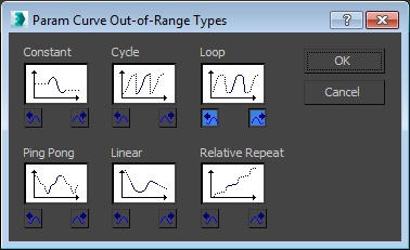

- Click
or go to Edit > Controller > Out Of Range Types - From the Out Of Range Types dialogue, select Loop.
![Animating in Forest Pack-image2015-2-15%2018%3A6%3A59.png]()
- The graph will now show a dotted line to indicate the new looped animation. Close the graph editor.

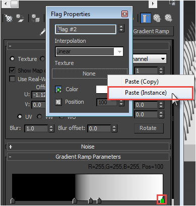

- Go back to the Gradient in the material editor and instance the Output map to the last flag in the gradient ramp.
![Animating in Forest Pack-image2015-2-15%2017%3A22%3A20.png]()
If you play back the animation now you'll get a growth that transitions into a looped bend animation with some randomisation added by the noise.

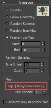

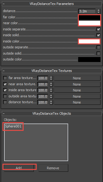

If you are a V-Ray user it is possible to use VRayDistanceTex to drive animations based on their proximity to a list of objects. To do this:
- Carry on from the previous exercise. From the Animation rollout, set the End frame to 30, click the Map slot and add a VRayDistanceTex map.
![Animating in Forest Pack-image2015-2-15%2018%3A48%3A28.png]()
- Drag the VrayDistanceTex map to the material editor and make the following changes:
![Animating in Forest Pack-image2015-2-16%201%3A12%3A39.png]()
- Enter a Distance of 3.2m.
- Click on Add and pick Sphere001 to add to the object list.
- Set the Far colour to Black.
- Set the Near colour and Inside colour to White.
- Select Sphere001 from the scene (It is set to display as a box). As you move it near the surface of the Forest Pack object the arrows will grow in that area.

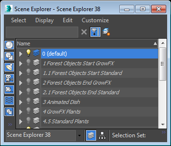

To get started open either fp_animation_start_mray.max or fp_animation_start_vray.max depending on your renderer. In the file there are a number of hidden layers you can activate.
To follow along with the tutorial, If you have GrowFX installed unhide 1 Forest Objects Start GrowFX, otherwise unhide 1.1 Forest Objects Start Standard. If you'd prefer just to see the end results, unhide either 2 Forest Objects End GrowFX, or 2.1 Forest Objects End Standard. In all cases the Forest objects have been set up for you with the exception of the animation, which we'll add by following these steps:

- Select Forest_Trees_Start.
- Set Time Offset to 15.
- Set Count to 6. (It's worth remembering that increasing the value increases memory usage).

- Select Forest_Grass_Start.
- In the Animation rollout turn on Random from Map and turn off Animate Only at Render Time
- Though we can preview the animation effects in points cloud mode, to see even more clearly the effects of the map we're going to create, it can be helpful to temporarily substitute the plant geometry for something simpler. A useful trick , especially if you're a GrowFX user, is to create a low poly proxy object that contains roughly the same animation as the full geometry. With GrowFX this is as easy as duplicating the object and deleting more-or-less everything except a single stem and the wind animation. Because this proxy object is driven by the same wind source as the hi res plants, we'll get a good indication of the finished animation.
- To enable us to fine tune the animation we'll use a 25m "patch" to help visualise the effect. This has already been created and added to the Forest Object. To enable it go to the Areas rollout and turn off the Surface Area.
![Animating in Forest Pack-image2015-2-15%2023%3A12%3A3.png]()
- Still in the Areas rollout, turn on Rectangle006 and adjust the viewport so you can clearly see the grass patch.

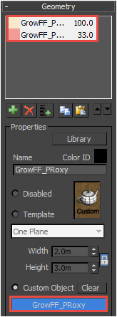

- Go to the Geometry rollout and select the two items by clicking their names while holding down Control. Click on the Custom Object geometry picker and select GrowFX_Proxy from the scene.

- Set the Time Offset to 7 and Count to 20.
- Drag the Gradient Ramp into the material editor as an instance. In the Coordinates rollout check Use Real-World Map Size, set the Width to 12.5m and the Height to 25m. If you play the animation now you'll see the offset is creating a wave-like motion, moving horizontally across the screen.
- To create a wave that moves horizontally and vertically we'll combine two falloff maps. Click on the Map Type button and select a Composite map.
- Click
to add a new layer and copy the existing gradient ramp to the new texture slot. Rotate the copied Gradient ramp by 90 degrees and adjust the width and height settings as follow:
![Animating in Forest Pack-image2015-2-15%2023%3A48%3A29.png]()
- Change the top layer's blending mode to Darken, The composite map should now resemble the image below. If you play the animation, you should see a wave effect running horizontally and vertically.
![Animating in Forest Pack-image2015-2-15%2023%3A49%3A39.png]()

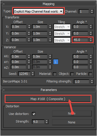

- If you have Bercon Maps installed, you can use it to add further distortion. Click on the Map Type button and select Bercon Mapping. Keep the existing map as a sub map but move it from the Distortion map slot to the main input. Change the Type to Explicit Map Channel Real World and rotate the map 45 degrees on the Z axis.
![Animating in Forest Pack-image2015-2-15%2023%3A58%3A22.png]()
- Set the Distortion Strength to 4. Add a Noise map to the Distort map slot and set the noise map's Parameters > Size value to 30.

- In the Animation rollout, turn on Animate Only at Render Time.
