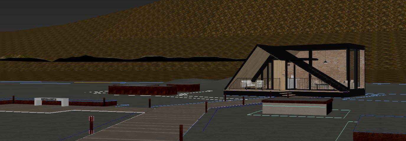

scene start
This tutorial is a making-of for the scene created by The3DGarden team, so we won’t be showing every step. Also to save time the tutorial starts with the bare bones already in place. We'll start by explaining how to add the plants in the easiest way possible … using presets.

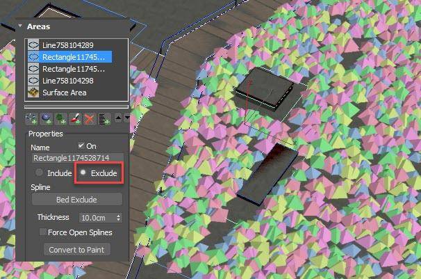

  8. You can add as many additional Areas if necessary. Here, for example, we added the spline areas that surround the raised beds. By setting these to Exclude we removed the grass. We also added the area in the front left side of the path. As you can see, very quickly we were able to populate this whole area with grass.

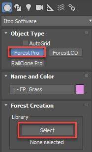

Now let's use another preset to fill in the other side of the path. This time we’ll demonstrate how to select a preset after the FP object has already been created
  1. Go to the Create panel and find the Geometry > iToo Software group
  2. Select Forest Pack
  3. If you right-click on the Library Select button, it ensures that no items that were previously selected in the library are used.
  4. Click in the scene to select a spline or a surface. We selected a spline to the left of the house.

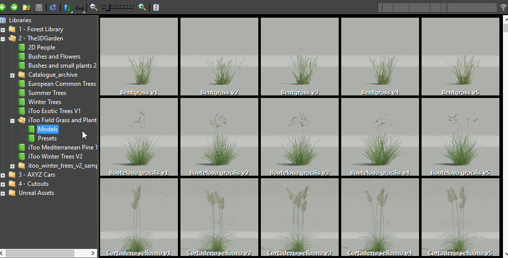

Creating your own mix of plants
Sometimes instead of using a preset, you might want to create a custom mix of plants. To do that:
  1. Create a new Forest Pack object, this time we picked the terrain.
  2. Open the Library Browser. We used the Field plants and grasses Models library. Here you will find 75 individual plant models in 15 species you can use to create your own bespoke scatters.
  3. Pick the assets you want to use, holding down Ctrl while you click to select multiple items. When you are done, click Import Selected

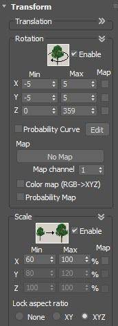

  4. Next, go to the Transform rollout and enable Scale and Rotation randomisation. Change any settings as desired. For example, here we slightly widened the range of Scale randomisation.

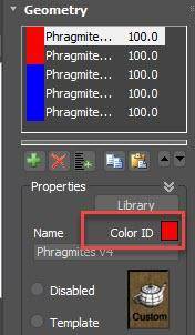

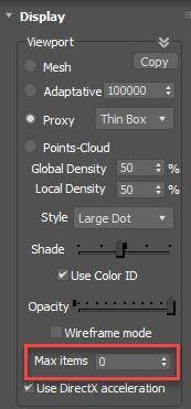

  10. Sometimes you might want to see more clearly which models are being scattered. One way to do this is by tinting the Points-Cloud or proxy using the Item’s Color ID. To do this, give each model or group of models you’d like to identify a distinct colour. We used Red and Blue.
    Colour ID

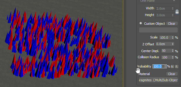

  11. Next, go to the Display rollout and enable Use Color ID. This makes it much easier to see what’s going on in your scatter. For example, we can now visualise the effect of changing the item’s probabilities much more easily.
    Probability

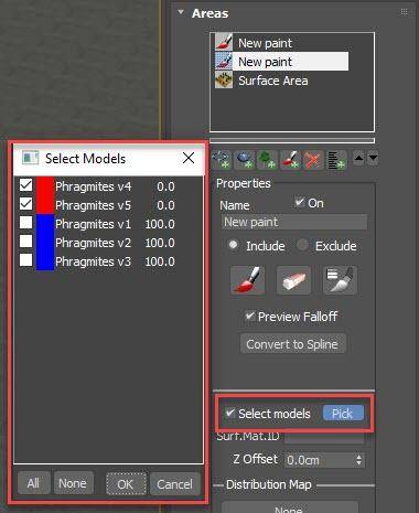

  12. While we’re here, we’ll just demonstrate another handy but often overlooked feature of Include areas. When you have multiple models like this, it’s actually possible to select which items are scattered per area. For example, if I only wanted to scatter one species in the area we just painted, we would turn on Select Models and click Pick to open the Select Items dialog. Just check the items you wish to display in this area.
    Selecting Models
  13. We added another paint area, enabling Select Models and choosing the other species. In that way, you can paint two different species exactly where they are needed but using just one Forest object. Pretty useful!

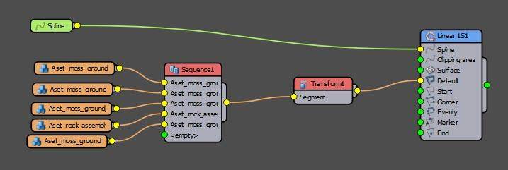

Scattering on RailClone objects
For a bit of fun, we wanted to demonstrate how the rockface in the background was created using RailClone, combined with Forest Pack to add some grass to the ridge. This part of the scene uses several rock assemblies from Quixel’s Megascans collections. They have been rotated into a vertical position and positioned so that their tops more or less align. We then reset the XForms and set all their pivots to a common point on the Z- Axis. We also combined the Materials into a multi-sub object material and reassigned IDs accordingly.
We can now use RailClone to deform these assets to follow a spline. Here’s how we did it:
Node graph
  1. First, create a new RailClone object
  2. Open the graph editor and add a Segment node. Right-click on the Segment node and select Clone Multiple
  3. Pick the rock assemblies from the scene.
  4. To avoid immediate repetition and because this is a short run, we ran these through a Sequence Operator. This creates a simple repeating pattern along the spline.
  5. Next, Create an L1S generator, wire the Sequence operator to its Default input
  6. Create a Spline node, wire it to the Generator’s Spline input and select a path from the scene. The rocks now deform along the path, but we need to adjust the pivots and overlap them. Instead of doing this for each Segment Node, we can add a Transform node after the Sequence operator. This allows us to make changes to all the items in one place.

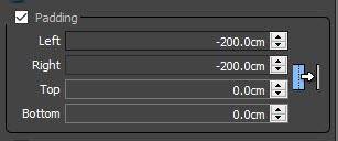

  7. To overlap the geometry, we enabled Padding and used a negative value
    Padding

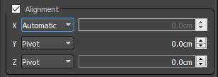

  8. Finally, we enabled Alignment and changed the Y and Z axes to use the Pivot we set up earlier.
    Alignment
  9. Assign the material.

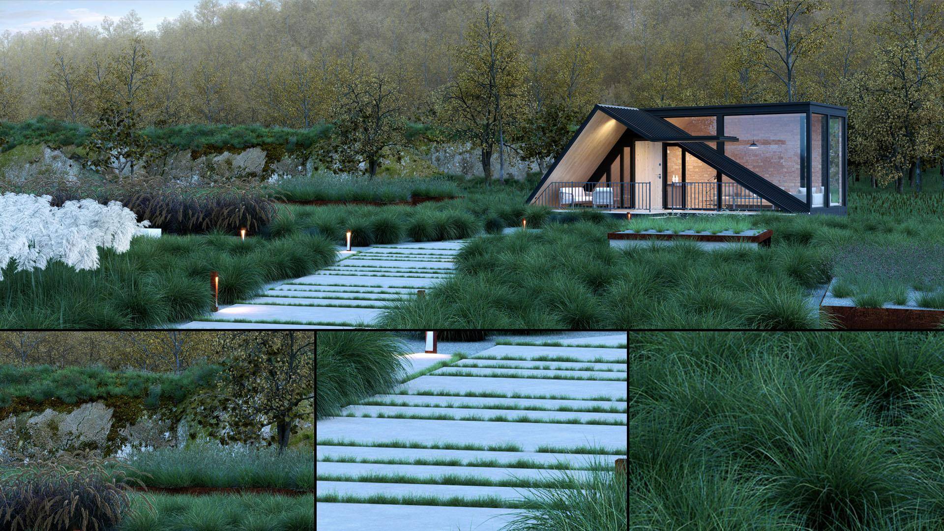

Growing grass between the paving
In the final section, we’ll take a look at the grass growing between the concrete slabs. To achieve this we created a new Forest Object using the Common Grass Field preset. We used a spline that encloses the path to define the area for the scatter.
  1. The first thing you’ll notice is that the grass is much too large. As I mentioned before, these presets are a great starting point, but can always be modified. In this case, we decreased the size using the Global Scale parameter found in the Geometry rollout
  2. To compensate for the smaller size, we also needed to adjust the distribution settings by changing the Density.

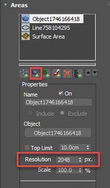

  3. Now we can remove the grass from under the slabs. To do that we’ll use an Object area. Add one and pick the slab geometry from the scene
  4. This works by creating a black and white map projected along  the world’s Z-axis. By default that map’s resolution is 512px, but by increasing this value, you will improve the accuracy of the collision detection.
    Object Resolution
  5. Finally, to remove those stray plants from the side of the path, we added a little bit of Density falloff
The last thing that we did to wrap this scene up is to add some trees from The3DGarden European common trees collection to fill in the background.
Final Render
