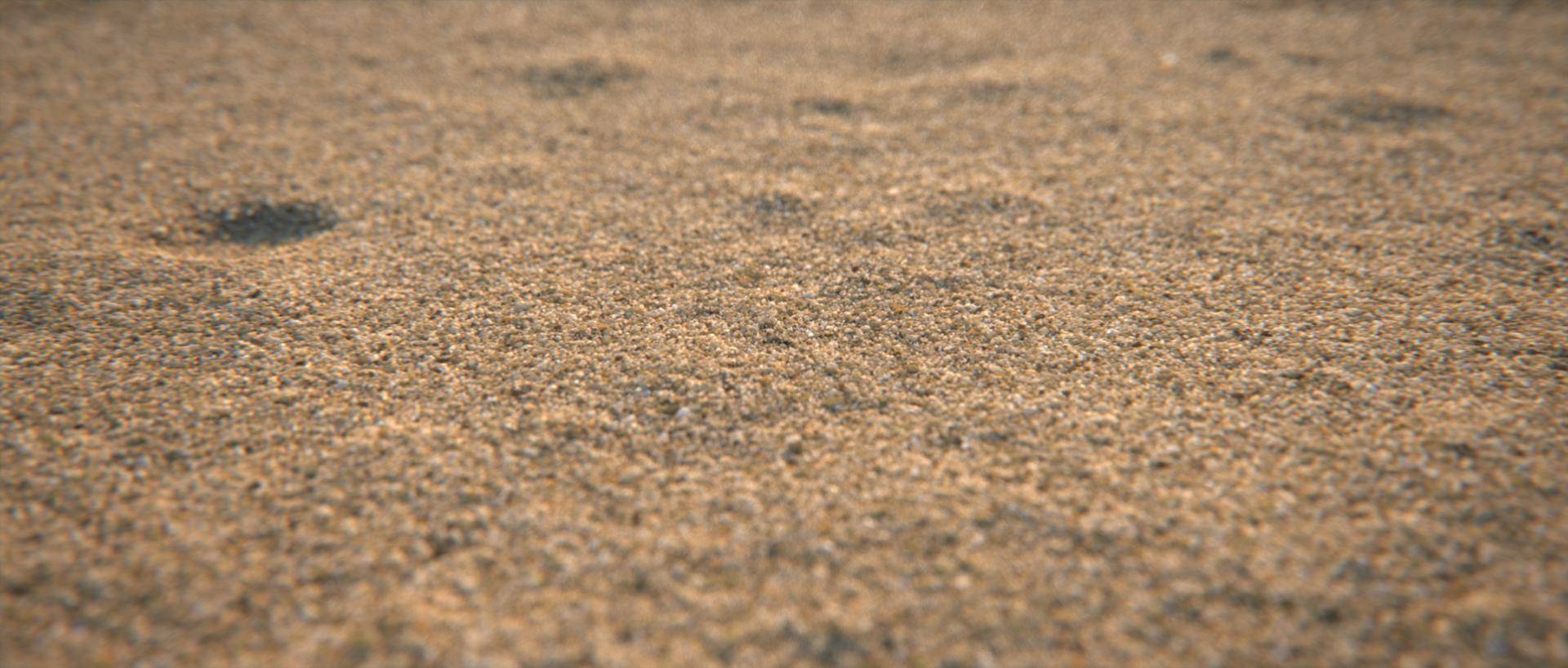

Before we scatter grains on our beach, we'll need a basic ground and lighting, to create this:
- Open the file called "vray_start.max" from the downloads for this tutorial.
- You will see a simple plane with a displace modifier, a V-Ray Sun (and Sky) and a Physical camera with an exposure control already set up.
- If you render now, you will get the results shown below. The texture on the ground will not really be seen, but just in case there's a small hole here-and-there between our grains of sand, we'll see texture instead of the sky:

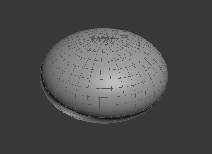

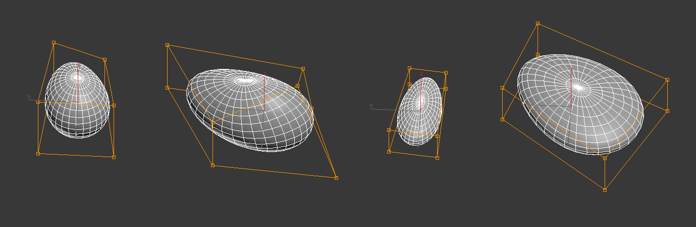

Create a sphere and squash it a little bit vertically. Add a FFD (2X2) modifier to it and deform it randomly. Duplicate it and tweak the variants so that you have enough difference between your grains.
- Duplicate these grains and manually randomise their rotation, scale and position to create a little patch. you can randomise the vertical position, but not too much, otherwise your grains of sand will either float or go through the ground.
Once you have created your patch, add a ProOptimiser modifier to it, followed by a turbosmooth and a noise modifier. This is to break the roundness of your grains and add crispy details to catch specular highlights.
Repeat the process to generate different patches. In the image below, I created 8 variants: 3 single grains, 2 large patches, 2 medium patches and 1 tiny patch.

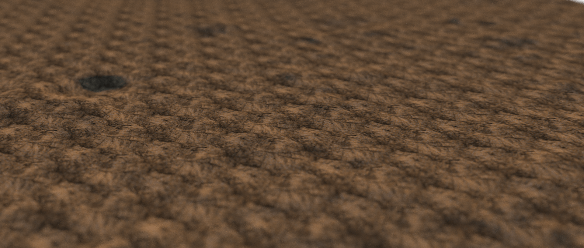

- This will fill the beach with a very dense cloud of grains.
Optimising the scatter
If you were to render now, you would scatter grains of sand on a huge surface and reach the maximum number of scattered items that Forest Pack can generate.

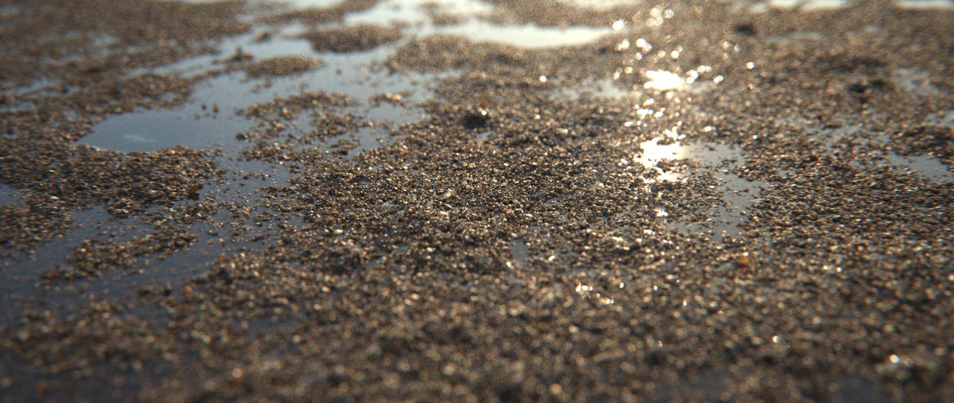

PART 5 : Taking it further, wet sand
Now we have our basic sand, we will make an alternative version of it, wet sand!
Adding water
- First, duplicate your ground and remove the noise and displacement map on this new instance. This will be our water surface. Set its Z Position to 3.875 so that it floats just a little bit above our ground surface.
- For the shader, use the following settings:
Modify the sand material
In the diffuse slot, nest the Forest Color map under a composite map, and add a new layer on top. Plug a brown V-Ray Color (value r:86 r:69 b:58) into this new slot and set to mode to Multiply. This will darken our sand to make it look wet.
Go to the Forest Color map in the Reflection slot and boost the right color of the gradient to a light grey (value: 180) so that it is looks more reflective.
- Set the Reflection Glossiness to 0.8 so it is a bit sharper.
- In the Refraction slot, change the mode to Get Color from Map and plug the provided bitmap refract_amount_map
- This will make your render faster and will work better with the wet sand look.
You're done! Hit render, and add some post-production to it, just like you did with the dry sand.
