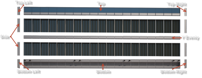

This style demonstrates the majority of the inputs of the Array 2S generator. This Generator has input slots for each part of the array, the exploded view of the curtain wall example shows the names of these slots and the geometry applied to each part (note that there is also an X-Evenly option that is not used in this example).

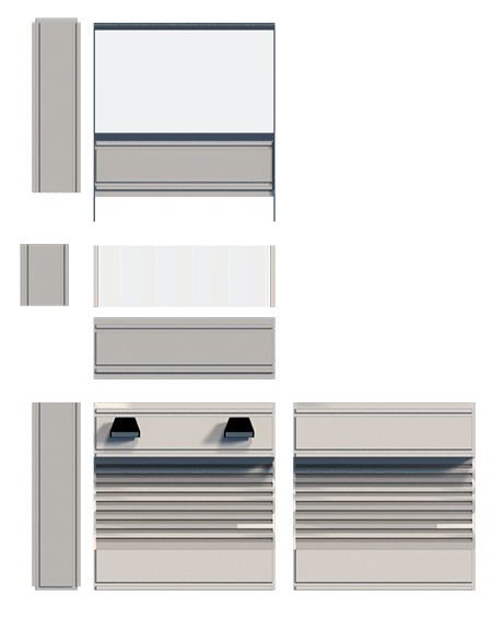

The scene.
The exercise files contain all the geometry and splines required to complete this tutorial. The final wall comprises 8 small modular elements as shown below. The windows have been constructed in such a way that the the floor-to-floor height to be easily adjusted simply by repeating the window element.
